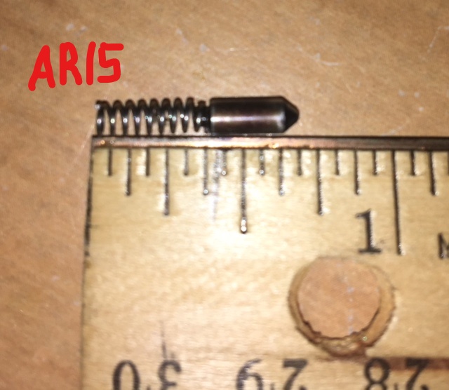

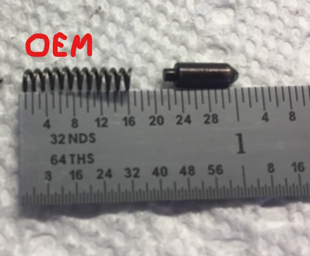

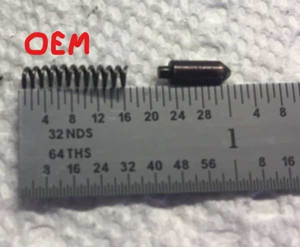

New to the P-64, but long time Makarov and Walther PP owner. I bought a few P-64s the other day and while reassembling them after the cosmoline removal ritual I lost the Safety Detent Spring. Not my first rodeo and ashamed I didn't use the large Ziploc trick. Anyway, after hours of searching gunbroker, Numrich and other sources that didn't have what I need I went into my toolbox. I grabbed an AR15 stock front sight post and eyeballed the skinny spring. Bottom Line: It works great! Cut a Stock AR15 Front Sight Detent Spring between 3/8'' to no more than 1/2'', lightly crimp the end if you want your detent pin to fit snug on the spring, and insert it into your P-64 slide.
I fully intend on finding that OEM spring in my garage or online, but having a disassembled gun is like a nagging sore to me. Hopefully this will help other novices who have launched their spring and cannot find one online or one at a reasonable price. AR15 parts are in abundance and can work in a pinch. If you don't have an AR15 front sight spring laying around, PSA is selling as of today for $1.99 a piece.
See Below for Original Spring and Modified AR15 Spring.
