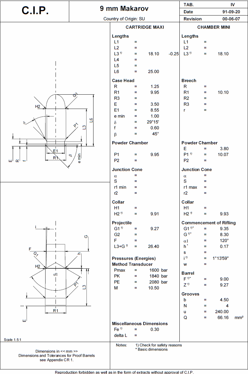

9x18 SAAMI and CIP specs
http://www.saami.org/pubresources/cc_dr ... akarov.pdf
http://www.cip-bobp.org/homologation/up ... page23.pdf
