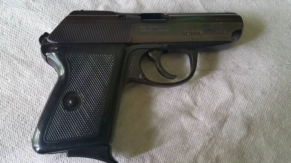

Got mine, oh about 2 months ago now. It has been problematic. First time out shooting, after the last shot, the slide locked open, but when I say locked, I mean LOCKED. The slide lock arm was getting jammed between the bolt face and slide housing. Was getting chewed up in the process. Took herculean strength to get it worked loose. Then it would lock up again after the next mag. And I had one incident of fail to fire. Full pull of trigger, no bang. So I've replaced:
- Slide stop lever
Slide stop spring
Recoil spring (18 lbs)
Firing pin spring
Hammer spring (18 lbs)
Magazine spring (x2)
Got most of the above items from Wolff Springs and the fellow on Gunbroker from Poland (laukert). I had my fears, but he's legit. Got my stuff in great condition, although, I kid you not, the package arrived in New York, then went to HAWAII! Then on to the midwest where I got it. USPS
Haven't had it out yet since these mods installed. I'm not put out by all this, my pistol has seen heavy use and the condition reflects it. It's been interesting getting it back up to shooting condition.
I do kind of like the patina on my pistol. It is very brown, not black at all like most of the others I've seen. So I guess I'm willing to put up with her quirks because of her looks.
