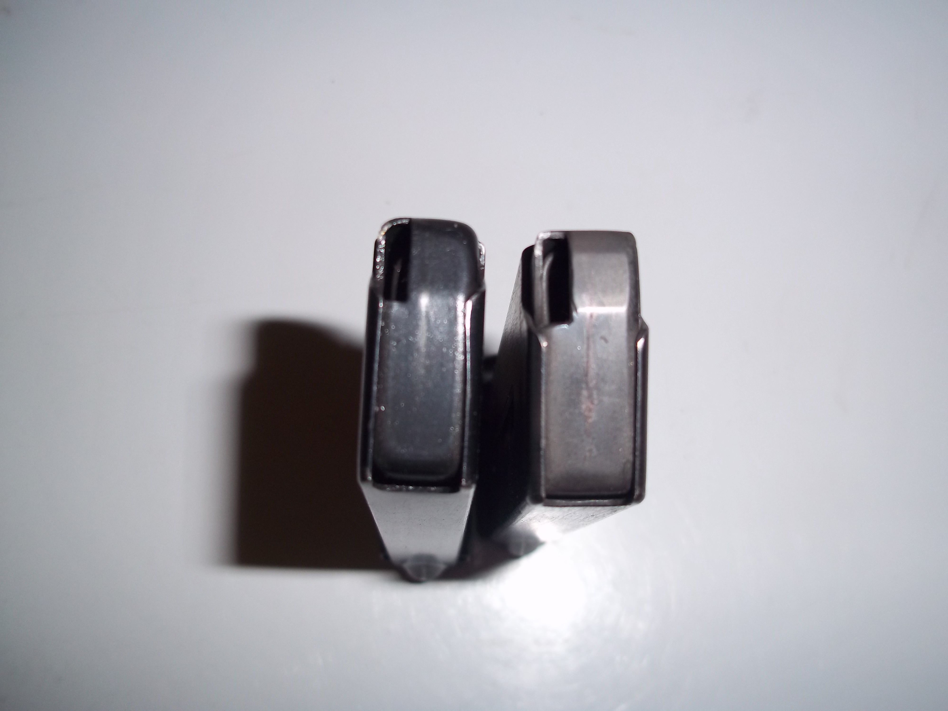

Re: P-64 not chambering
You have a P64 built in the year 1967. It might be a problem with the mags. The Poles changed the construction of the P64 around 1972 and made the feed lips on the magazines slightly longer which will cause feeding problems if you stick a "new" (post 1972) P64 mag into an "old" (pre 1972) P64. "Old" magazines will cause no problems in a "new" pistol.
Here is a picture i found on the internet for comparison.
