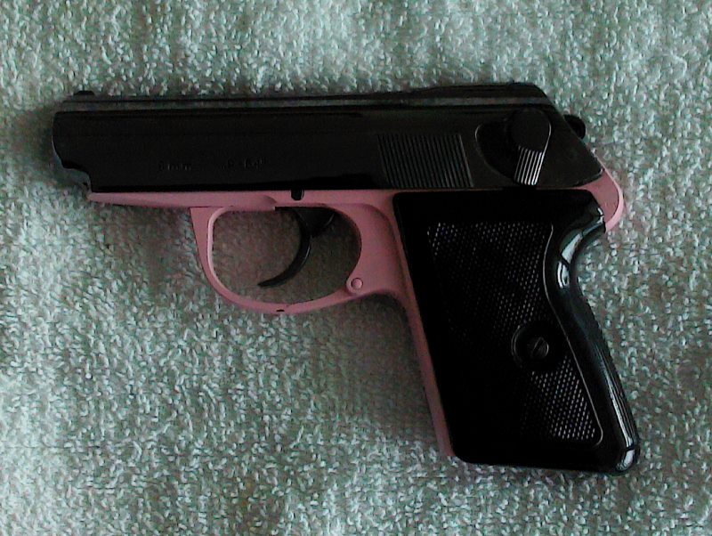

Hello Everyone...First post on the forum...
I got this P64 for my wife who fell in love with it after seeing it....Pink and black...
Took it to the range and found out it has several problems...
1, The safety has no problem staying in the non firing position...When it is raised to the firing position...one or 2 shots can be fired then the safety flops down to the safe position. This always happens.
2, The trigger pull is difficult for her...she gets it 3/4 back and can not get it back all the way to fire.
3, Its difficult to rack...In all honesty, I have a hard time racking it...
If anyone can give advice on how to fix these problems or what parts should be worked on or replaced... it would sure be a help...thanks in advance.

Welcome to the forum.
Trigger pull can be helped by adding a lighter spring but the SA trigger pull will be very light even to the point of a hair trigger.
Someone may have already put a heavier recoil spring on it already. You can get lighter springs at Wolff springs.
There is a post and vid on how to replace the hammer spring viewtopic.php?f=1&t=5074&sid=c79f59ce2a ... 4cd49685It
As far as the safety dropping you can start troubleshooting using this thread.
viewtopic.php?f=3&t=2121&p=24204&sid=c7 ... 685#p24204
Let us know how you make out.

As much as I love the P-64, and it is my concealed carry gun; In this case I would strongly suggest that she carry some other gun that she can fully manipulate.
drunkenjack wrote:This is my first P64...I have a Russian and a Bulgy Mak...So... I am not familiar with its safety features...
Would this problem child be safe for her to carry already racked with one in the chamber with the safety on...I am concerned with her accidently dropping it... etc...
Yes, that would be perfectly fine. The decocker/safety on the P-64 does just that. It decocks the hammer as it blocks and holds the firing pin at the same time. The firing pin actually has a little nub or detent on it's side that the safety grabs onto. When the decocker/safety is engaged the firing pin will not move. You can see pictures of how the firing pin and safety interact in this post:
viewtopic.php?f=3&t=4809&p=45895#p45895
I would never advise anyone to carry not loaded. If you don't already have one in the chamber, well in my field we call that a "dead man's gun". However in your original post you did not mention this was going to be a carry gun for her. That said there are several issues that need to be worked out before you even consider her carrying it.
Of course the first issue was the malfunction; Curly posted you a link on how to fix that, there are several other good posts on here about that issue. It's an easy fix. Here are some other threads to help you on it:
viewtopic.php?f=1&t=5148&p=48142#p48142
Good pic of bad spring: viewtopic.php?f=3&t=1045&p=4955#p4955
Good pic of bad detent: viewtopic.php?f=3&t=1045&p=43843#p43843
Don't go buying Walther parts, the safety detent and spring are available. On Gun Broker, laukart has them brand new. He does not have them listed at the moment but I'm sure he has them, you can email him here: sklep@laukart.pl or watch his listings here: http://www.gunbroker.com/All/BI.aspx?In ... ers=467151
The second issue was the trigger; The link Curly gave you was a pretty good one. Just keep in mind the lighter you go, the more of a "hair" single action the trigger will be. I would not suggest anything lighter than the 18lb one.
Once the above issues are worked out; the third is going to be most important and will take the longest to work on. If the P-64 is going to be a carry gun, the shooter must be able to fully operate it. If not, then you need to really consider something else to carry! She needs to practice ALL the functions of the gun. The best/safest way to do this without damaging the P-64 is with a mag loaded with snap caps. For each snap cap have her practice loading it (racking the slide/chambering a round), moving the decocker/safety to fire, and firing it while holding the sights on a target. If you are helping her you can load the snap caps (as they are ejected) into a second magazine so she can use that one to practice reloading at slide lock.
This all needs to be one fluid motion before she even consider carrying this P-64. When seconds count, the muscle memory will take over. If she has not mastered the full function of the weapon, then seconds will become minutes, minutes will become hours and it will be all over. Simply having a round in the chamber is not the answer to ones inability to manipulate the slide. What happens if she gets a dud, or failure to feed, etc? If she's mastered the above practice, muscle memory will almost seamlessly correct it.
