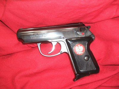

Just something I did to make it a little more attractive.

Nice... I like it! Where did you find the Polish eagle emblem? Did you embed the emblem into the grip or is it glued on?

The pendant is a Polish Eagle Round Lapel Pin from the Polish Art Center in Hamtramck, Michigan and was $2.50. I bought several.
The pendant was 7/8" so I used a 7/8" Forstner bit on the grip and then slowly filed down the pendant until it fit snug and flush in the hole I drilled (all eyeballed but turned out OK).
It is held in with E-6000 adhesive (jewelers use this adhesive) and I believe it was $4 at Big Lots.
Glad you like it. It turned out fine and for me that is something.
