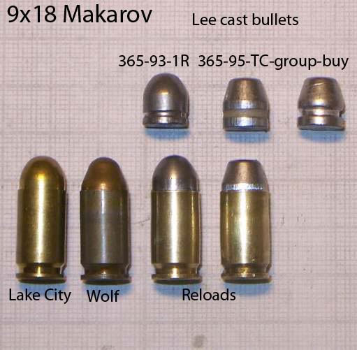

The weight of the .365-95-TC is 95 grains cast with WW. The weight of the Lee drops at 100-101 for me with WW.
The TC feeds better than the Lee round nose in my p-64. I just ran 100 through it flawlessly.
Attached is a photo from the Cast Boolit forum someone else took. It is a good comparison of the two bullets.
