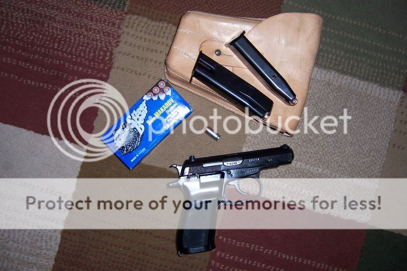

I used this on this 45 auto you have to sand blast first and then bake it , you have to do the same thing with Dura coat and Ceramic Hearder pait is a lot cheaper
or you can cold blue it like this one

you could try this "oven" I made to bake works for me but since Norm turned me on to the header paint that is about all I use now but do bake in this oven. Have also used the alum-hyde with very good results also. it is Brownells version of dura coat.

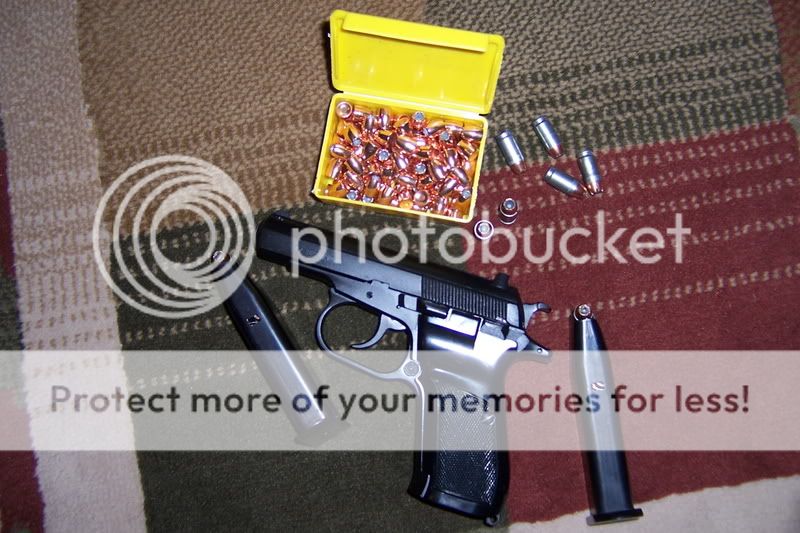

I bought a CZ-82 from J&G before I bought the P-64. Almost all the CZ-82's have wear on the front of the grip frame from the extra magazine rubbing on them in the holster. I blasted mine and Duracoated it in Matt Black. I also bought some tritium sights from CZUSA and installed them on the pistol. Duracoat is easy to use and apply. I have done several guns including my 9 MM sub machinegun.

really nice work..
