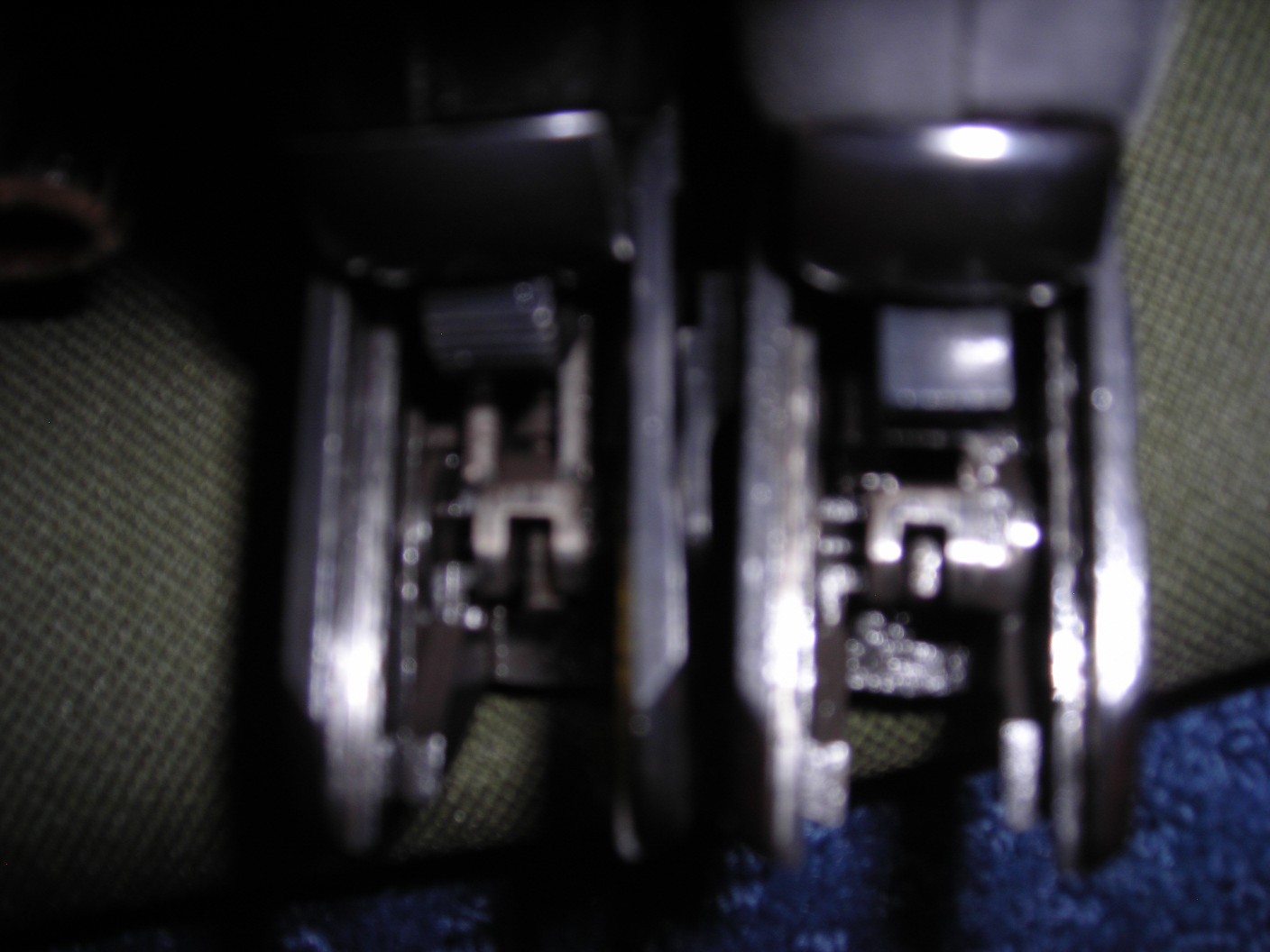

I agree. Do not recommend any dry fire of P64. DRY FIRE AT YOUR OWN RISK. The safety is small and possibly more of a concern than the firing pin. Removing the pin does nothing to protect the safety and MAY make dry firing harder on the poor little safety barrel. An above member mentioned an inertia firing pin. Then there could be two pin lengths. How about now two different type firing pin forces by way of the hammer—inertia and driven. The longer pin being driven and the shorter one being inertia? This is what these two P64’s have—I guess? All I know for sure is that when you hold the shorter protruding pin flush with the safety barrel it is barely protruding into the chamber. Not so on the other one. Flush equals firm primer strike. On left is round hammer 71, right is triangular 76. Thanks for all the help.
