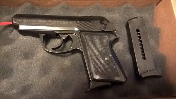

looks like it saw service but in great shape. not for sure though. heres a pic
Re: my p64 has a light da pull since i bought it
It's possible that if it saw service the owner at the time had some work done on it.
Nice example.

what do you guys think of the condition of the p-64 looking at the picture?
Rancher9
Posts: 10
Joined: May 26th, 2016, 7:56 am
Post by Rancher9 »
The external Bluing on the slide, near the muzzle of your p-64 is a lot better than mine. More wear on the trigger and trigger guard than mine. I just did a Wolff spring up grade on mine. the da pull is around 7 to 8 pounds (fish scale measurement), which is a bit heaver than yours. Over all, it looks like a great buy.
