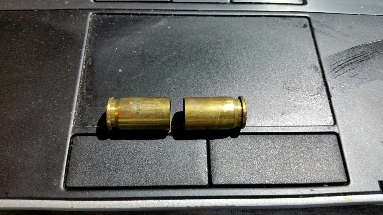

Hi All,
Wondering if anyone else has experienced casings that show a swelling pattern after firing, as shown in the photo.
They are quite consistent, and show a half-moon shape at the base of the casing.
I primarily shoot Prvi Partisans, as they're inexpensive, available in bulk shipments, and I've never had a problem with them in firing. And their hollow points are quite accurate, when fired from my P64.
This case swelling pattern looks to be aligned with the feed ramp of the P64, as it remains an open area when the breach is closed and a round is in-battery.
Not sure if this is a regular trait of the P64, or if I've got a problem in the making.
Would appreciate some expert feedback.

IIRC there are some posts in the forum discussing this and it is due to the open space on the side of the chamber.
Try a search and see if they pop up.

And the casing problem seems to occur with Privi Partisan more often than other ammo. We think they are loaded a bit hotter, European ammo often is. Or perhaps they are using a bit thinner brass.

As for the casings, I see this amount of deformation pretty consistently on all my PPU brass, since I switched from steel-cased shells (Wolf maybe?).
The swelling hasn't approached the degree that I've seen on some posted on this board, so I'm thinking I will just monitor the condition to make sure it doesn't worsen over time, or across batches of ammo.

Privi Partisan seem to a softer brass , I know there rifle brass is , , but great brass for reloading , don't have to reanneal for almost 5 shots , and dose have be trimmed almost every shot about the same length , its almost a soft as starline brass witch (IMHO) is the softest brass made

I made a post many months ago concerning "Glocked" brass from my P-64. I had just bought the pistol and PMC was the first ammo I tried (the only 9x18 in the store).
Mine bulged exactly like your photos (unsupported area of the chamber).
A 9x18 resizing die wouldn't entirely remove the bulge, so I scrapped all the PMC brass I recycled.
I bought some 9x18 Starline brass and some Speer bullets and loaded my own ammo. They fired fine and the brass came out fine and without bulges.
My supposition is that PMC's ammo is loaded really hot, and that's what caused the bulge.
My homemade Starline/Speer/Titegroup ammo was loaded at Hodgedon's recommended safe starting load, which is not too hot. They worked fine but grouped about 3" lower that the PMC ammo.
