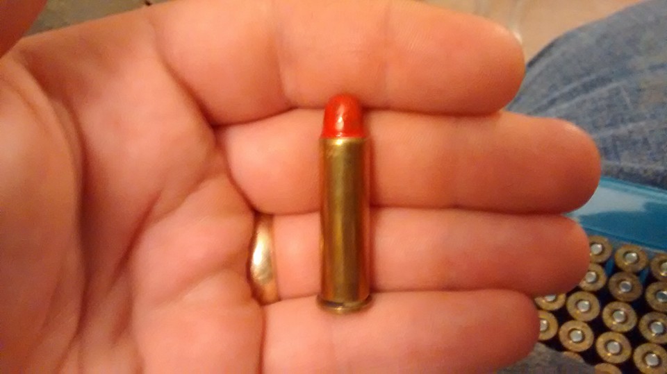

I powder coat my own, although it takes to long to process 500 rounds. Lately I have been buying Mo. Bullet Co coated lead ammo. Very happy and shoots very clean.
I have a 357 that leaded up about everything I tried. With coated bullets no leading.

I've had good success with 158gr .358" PC bullets in a Ruger Vaquero .357 Mag. Loaded them up to almost fullpower jacketed velocity with VihtaVouri N110. I tumbled them around in a ziploc bag for a minute or so by hand. Bake them in a toaster oven for 15 minutes on about 375 degrees. Leading has been non-existent. I have yet to find any lead streaks in the barrel. I'm glad I've switched over to this method and I'll have to do further testing.
