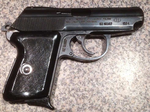

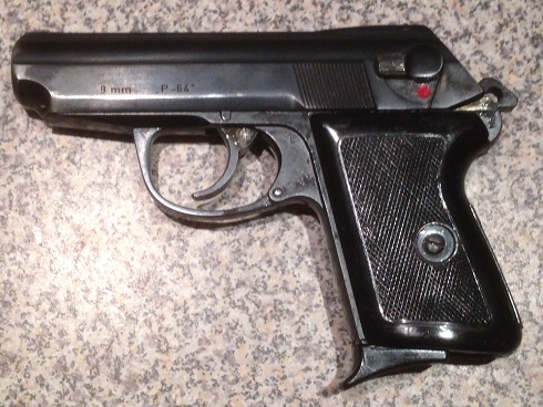

Here are a couple of views. It's definitely not unfired - wear on the finish from holstering and on the outside of the barrel from the spring dragging - but the bore is chrome-clean and sharp and the whole thing looks good to me. So far it reliably goes bang on command, too, so I'm pretty happy - now that I know where NOT to put my left thumb:

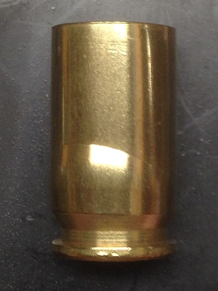

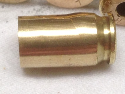

Tonight I was prepping the cases from Wednesday's shoot and found about 10-15% of the cases had bulges on them at the bottom, next to the case head. Same curved outline on those that had any at all, though the amount of bulge varied. The bulge only came from firing, the case in the pictures hasn't been sized yet. I've read about bulging due to bullet setting but this is not it.
Cases were commercial PPU ammo Tuesday and once-fired PPU cases today so not yet reloaded. PPU 7.62x54R factory ammo was a little hot and had pierced primers so maybe they load the 9mm Makarov a little hot, too?
I've been reloading .30-06 and 7.62x54R for about a year but none of my bottle-neck rifle cases have looked like this and I just want to make sure it's OK to go ahead and size the bulge away and not some sign of inadequate case strength. It almost looks like that part of the case is unsupported in the chamber. Could that be?

As far as the brass bulge check this thread it mentions unsupported chamber also..
viewtopic.php?f=1&t=5342&p=49650&hilit= ... ass#p49650
Re: New-to-me P-64 to the Range
Welcome to The Brotherhood. Sounds like the bug for this little piece of wonderment has bitten you too as well as the gun! PPU ammo has been nited before as a little hot. In fact most european ammo is loaded hotter than US loads. I would try some Hornady ammo to see if your still getting the bulges. And you could try chrono'ing any of that lot of PPU if you have any left to see what the FPS is. Oh yeah, and we ALL learn to keep out thumbs out of the way. :oops:
