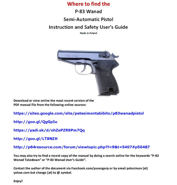

Hello lklawson and P64 / P83 fans! This is my first post here, so please don't axe me just yet, haha .
I was also looking for details of the P-83. So I searched loads and loads even in Polish (don't speak any though) and found some pointers. Well, ultimately, I thought I should compile a kind of user's guide with 31 pages based on all the data I found. Feel free to take a look and please either make changes yourself or let me know how to improve the document. Page 23 "Detailed Parts Diagram and List" really needs to be proofread and corrected. I'm so bad at manually naming parts there. By the way, have you posted your take-down video to youtube? I'd like to see it. The document is attached to this message, and checkout these links:
* most PDF files are ISO 19005-1 PDF/A-1 compliant. Fonts and bookmarks are embedded inside these PDF files.
* also provide a DjVu (DjView) document format for Linux/*nix and Android open source lovers.
* please review all links in the body of this post.
PDF on Google drive (viewing online degrades photo and diagram quality)
View: http://goo.gl/QgGpIu
Download: http://goo.gl/pjTJ8V
PDF on Dropbox (viewing online may degrade photo andi diagram quality)
http://goo.gl/LT8NZH
PDF on Yandex.Disk
http://goo.gl/DJw7Gb
DjVu document on Google Drive
http://goo.gl/JOUWMq
DjVu on Dropbox
http://goo.gl/o0OxuJ
- get WinDjVu reader software from http://goo.gl/2RLLXv or get something else from http://djvu.org or http://djvu.sf.net , and for Android mobile devices http://goo.gl/AYPwew
Microsoft Word 2010, DOCX file for editing
- on Google drive
https://docs.google.com/uc?export=downl ... TlEWHhNOUE
- on OneDrive (SkyDrive)
http://1drv.ms/1X1udw2
Google Sites page
https://sites.google.com/site/petesimon ... anadpistol
The Internet Archive, Community Texts:
https://archive.org/details/P83WanadPis ... deInPoland
an article in world wide wikipedia
https://en.wikipedia.org/wiki/P-83_Wanad
Cheers!

Re: Detailed takedown of P83
Welcome to the forum Pete.
Thanx for posting the links.
