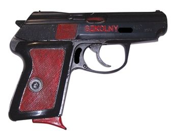

While I wait for the new parts gun to arrive I thought I would start a log of my restoration of the training gun. Here is a picture of how the training gun looked when I got it.
http://i1287.photobucket.com/albums/a62 ... 83198d.jpg
As you can see in the picture the barrel and frame have a hole cut in them at the chamber. The slide has the word SZKOLNY (SCHOOL) engraved into it and the firing pin hole has been welded shut. The firing pin has also been shortened bu about 1/2 an inch.

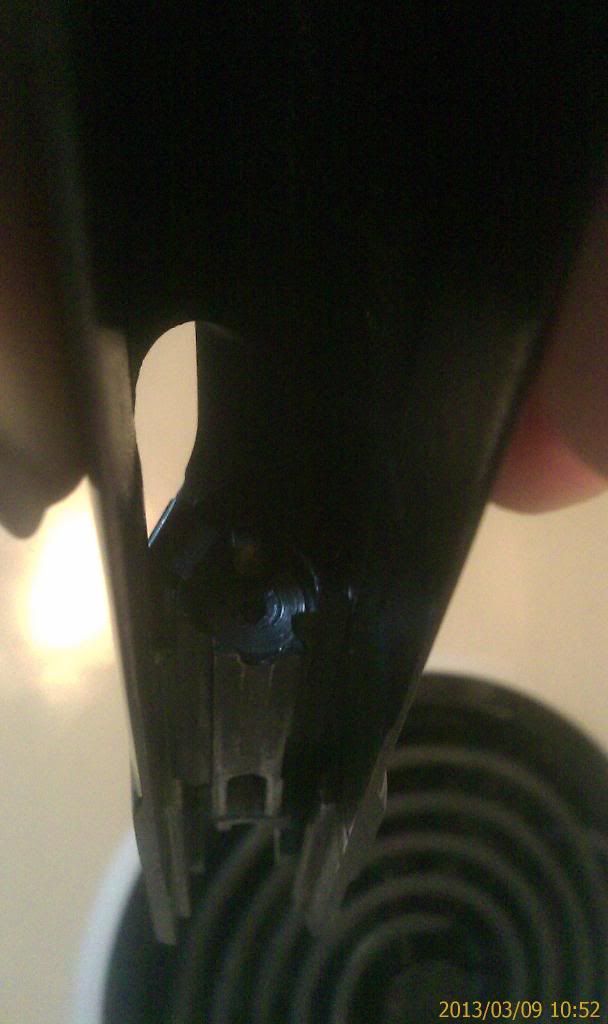

I began by striping the slide and drilling out the weld in the firing pin hole. I used a 3/32" drill bit and a hand drill. Here is a picture of the new hole.
http://i1287.photobucket.com/albums/a62 ... 9109a9.jpg

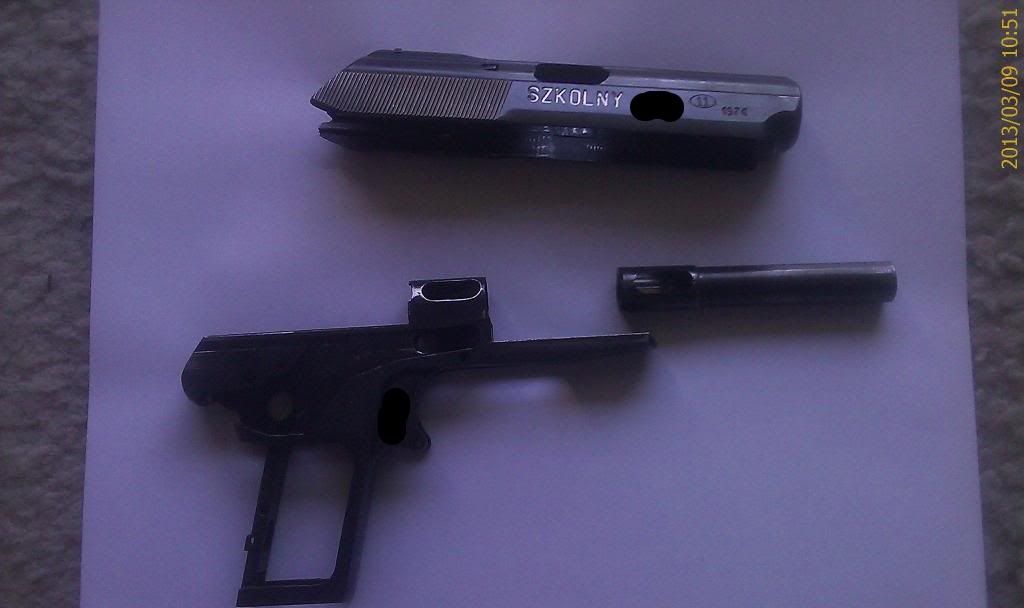

After working on the slide and grips I stripped the rest of the parts off of the frame and removed the barrel
http://i1287.photobucket.com/albums/a62 ... 1e7414.jpg
The barrel tapped out easily once the retaining pin was removed.

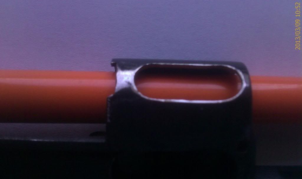

Here are some closeups of the holes in the frame and barrel
http://i1287.photobucket.com/albums/a62 ... 885c28.jpg
http://i1287.photobucket.com/albums/a62 ... e02efb.jpg
Once the new parts gun arrives I am going to use the barrel and firing pin to complete the restoration.
