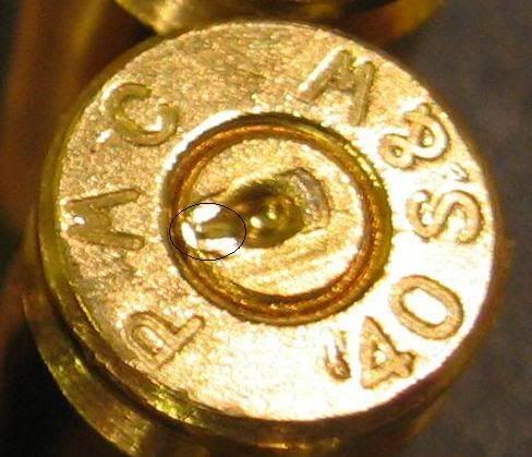

I know nothing of a Wolff trigger spring. There will be a long coiled spring that came with the heavier recoil spring. This is the firing pin return spring. Wolff recommends you install it because it gets the firing pin recessed into the slide during ejection faster. This prevents the firing pin from catching the primers as the empty case ejects. This can damage your firing pin tip. Evidence of this dragging can be seen on the primer and they're called striation marks. I'd recommend you replace that spring. It's not terribly bad, just remove the safety out the side of the slide. Be sure to catch the detent and its spring. Norm suggests using a large clear bag so it'll be caught in the bag. Once the firing pin is out, you can swap the spring, reinstall it, install the safety detent & spring, and last the safety. It's not too awful. Go to the assemly guide here:

Here's a picture with a drag mark on the primer due to the firing pin not getting inside the slide fast enough.
