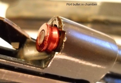

Hi guys new to the forum. Just purchased a P64 shot it today for the first time. Just happened to see an empty casing and it was bulged big time. There was a gunsmith at the range I was at and we noticed that the feed ramp is machined way up into the chamber and the bulge is the exact shape of the ramp. With a round chambered the feed ramp leaves an unsupported area at the bottom of the case I was shooting prvi partizan 93 gr. fmj every case was exactly the same :?: any ideas now I am scared to shoot this thing :shock: I'm gonna shoot some steel case and see if it does the same thing pray for me :D

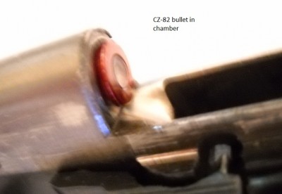

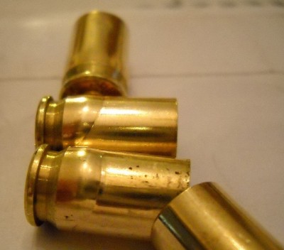

Re: Buldged Cases
I've never experienced this problem. I never shoot factory ammo unless it's steel case. All my brass cases are reloads made from cut down 9mm Luger cases. Every one of my brass cases is nice and round with no bulging to be seen by the naked eye. Here are pictures of my feed ramp, which looks like everyone elses. The other picture is with one my my fired brass cases.

Just wanted to chime in on this, I know this is an older thread, but I just got around to shooting some of my PPU 9x18 makarov rounds from Aim Surplus today, and my casings are bulged just like in the above photo - it really freaked me out. I've shot plenty of steel cased ammo through my P64 with no issues. So much for reloading this brass!
